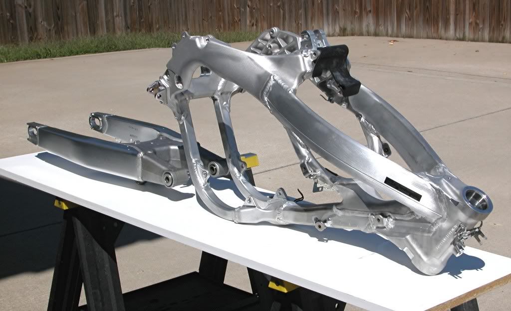

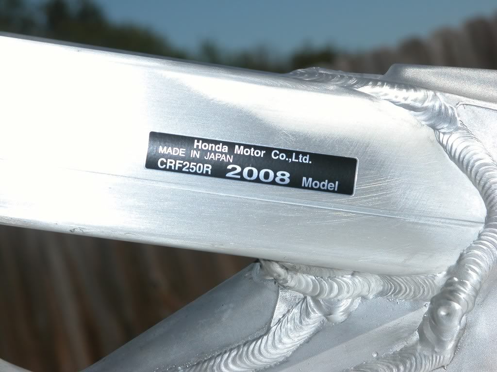

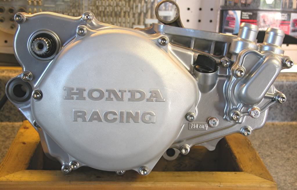

Finally got my first (and probably only) AF project started. I have
been acumulating parts for several months. I have the suspension
and wheels, and I just picked up a frame and swingarm from a
Honda dealer that was parting out a 2008 CRF250 right out of
the crate.
I started assembling the engine a few days ago and just finished
the bottom end. I hope to have the rest of the engine finished
within a month. Once the engine is done, I'll start on the frame.
I am posting some pictures of a few of the items so far.

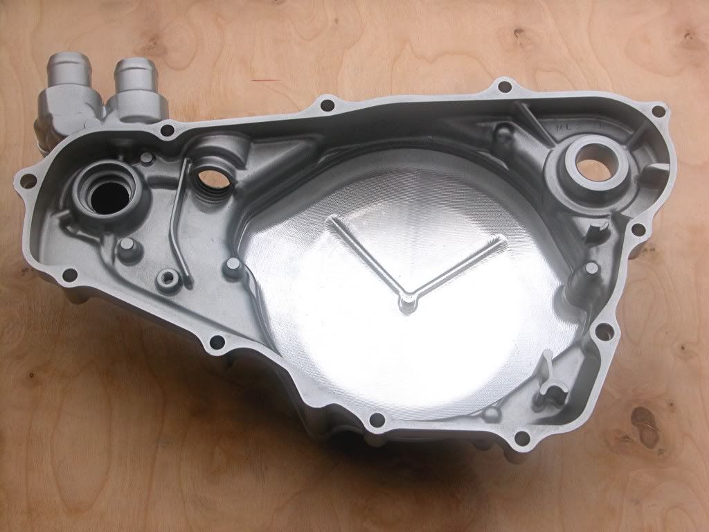

nice covers, where did you get them? and good luck with your build

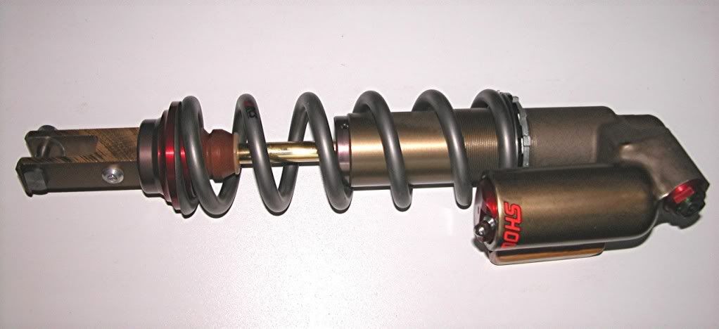

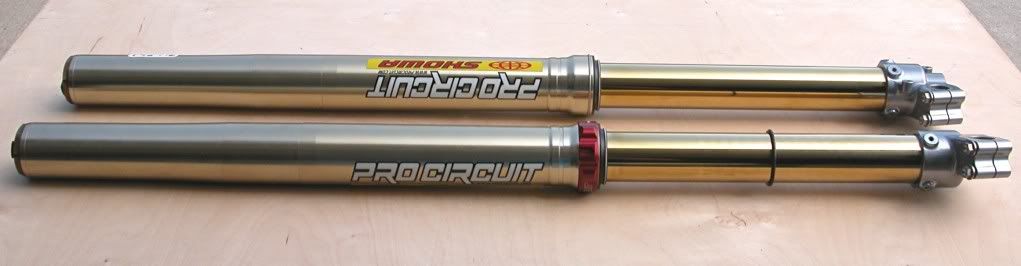

is that a showa a kit or pro circuit modded suspension

X2 on the covers! Where's the Engine ID Tag? Looks super clean so far!
I got the clutch cover from a guy in the UK that machines
them from Aluminum. The cover is pretty stout and
comes with the oil feed casting used on the CR250.
That casting needs to be ground off for the 500.
Here's a picture of the back side of the cover.
The ignition cover is a Magnesium HRC part I managed
to get along with a trick HRC close ratio transmission
from an old "friend".
The forks and shock are the Pro Circuit "works" suspension
they sell.

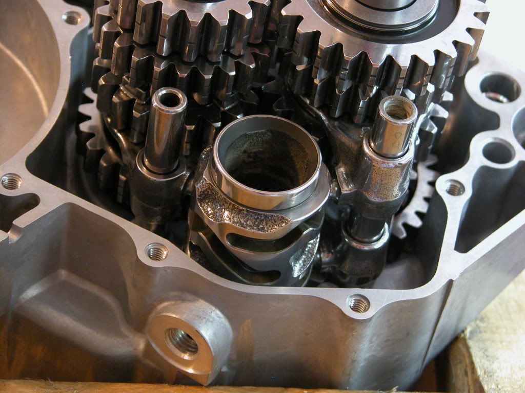

In addition to the works tranny, I had all the internals REMed, the
reciprocating assembly balanced by Crankworks, Hinson Clutch
outer. The cylinder and head will be done by Eric Gorr (mo-betta),
VForce 3, Keihin 39mm PWK, vortex ignition controller with a 2000
Honda CR250 stator and flywheel and a Pro Circuit pipe and silencer.
Should be a strong but useable powerband.
Here is a picture of the REMed transmission clusters and shift drum
assembly. The metal is super slick now.
