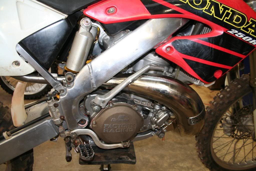

bought a 01 cr 250 a week ago allready have the motor in waiting for the billet y piece to complete it
and the spadge racing sticker is staying
the rusty pipe adds a nice touch :lol: . j/k man it looks awesome. keep us posted on the progress :cool:

yeah thats a dead pro circuit pipe from my sons bike hes bikes on here also

The pipe isn't dead its just weather beatin. :D ( chartacter lines )

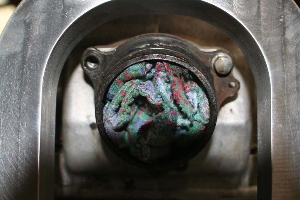

got the y today we fitted it tonight made some alterations that we new we had to just to get the new cradle tubes to fit the y the down tube is a extrustion with a web in it so the y needs a 3mm slit cut in the top and because you cant buy the right tube for the cradle we converted ours to 25x25x3mm photos soon

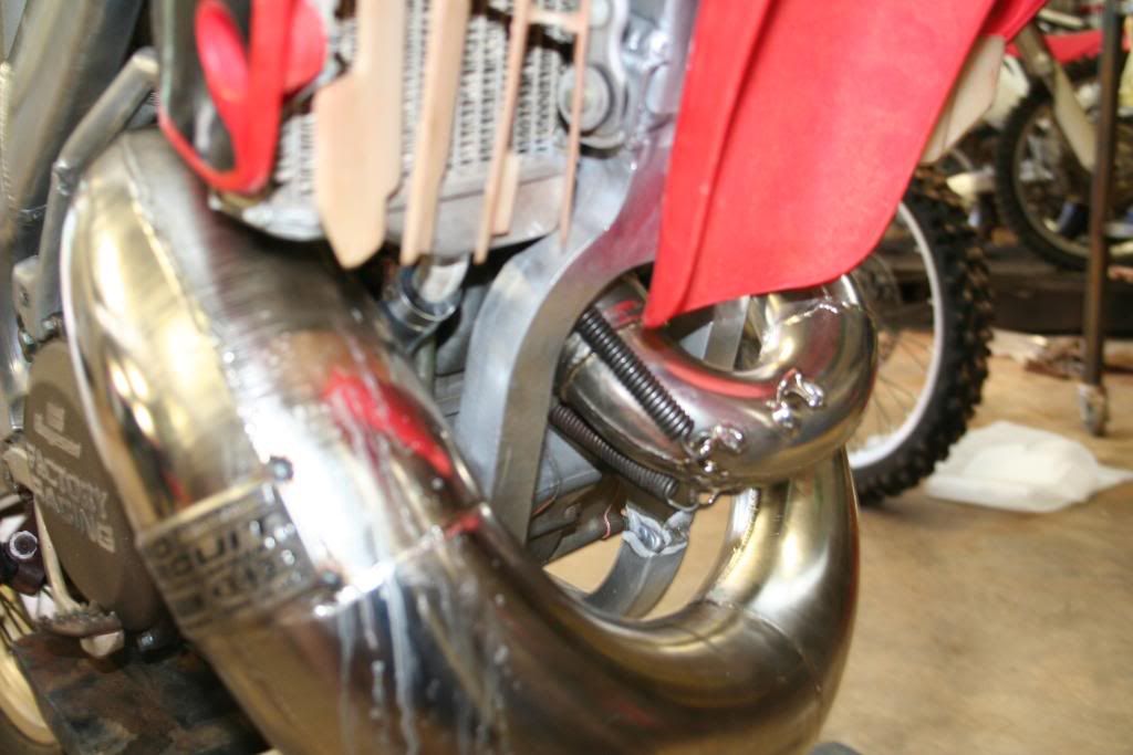

ready for welding this weekend

Wow, that is coming together really nice. The cradle tubing under the engine, does that bend inwards in front of / near the bottom engine mounts (it looks like it does in the photos).

the frame tappers from the swingarm to the y piece so the tubes need a twist or a bend to get them to line up and at the moment they look alot misaliged because they are loose and hav not been tacked up

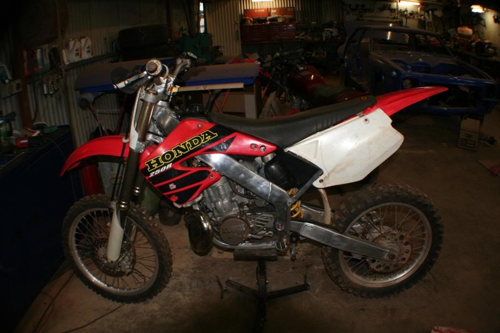

fired it up tonight we are running the full ignition out of the 01 cr250 it fired 3rd kick and idled sweet after a tweek it sounds like it revs quicker than mine so cant wait to take it for a spin, waiting on a new shock linkage and we are all go. :lol:

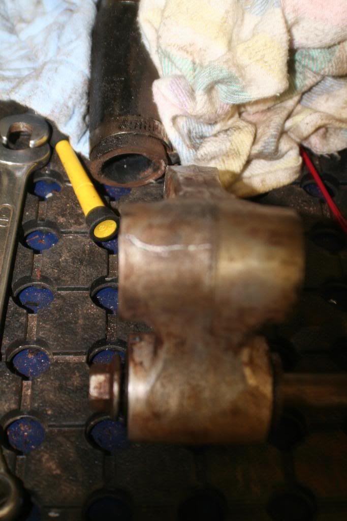

shit photo but the linkage had a hairline crack in it and when we were removing the bearings it opened up lucky it did in the shed and not over a table top or a double
