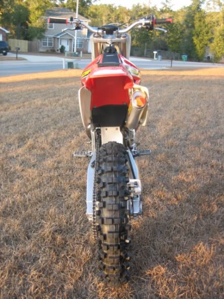

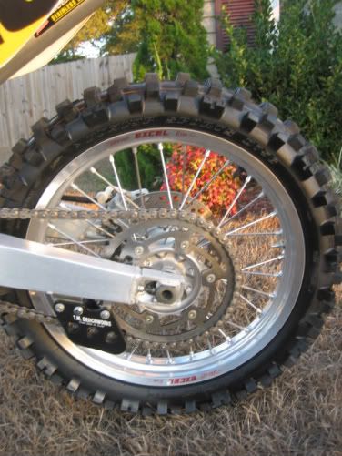

britincali wrote:The sizes arent realistic, the 140 in a michelin aint much bigger than a 120 dunlop.
Yup, in terms of footprint. What sets Brits tire apart from mine is the sidewall = Rim protection / flat prevention.
Brits 18"
My 2.50x19"
Notice how the either edge of the tire doesn't bow much inwards where the shoulder knobs become useless but at extreme lean angles.
