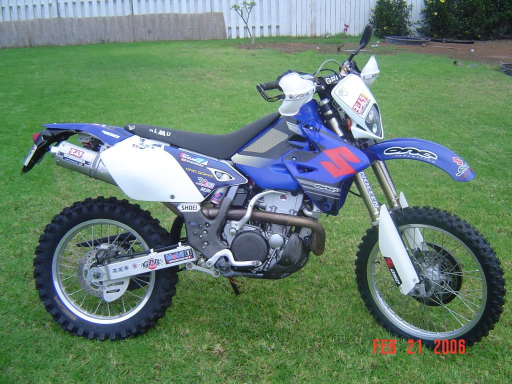

I guess to go fast I'll use my DRZ450S (boo hiss, boo hiss....I can hear you guys now :lol: :lol: ) She's built to the hilt and reliable as an anvil.
BRAAAAAP! :twisted:
