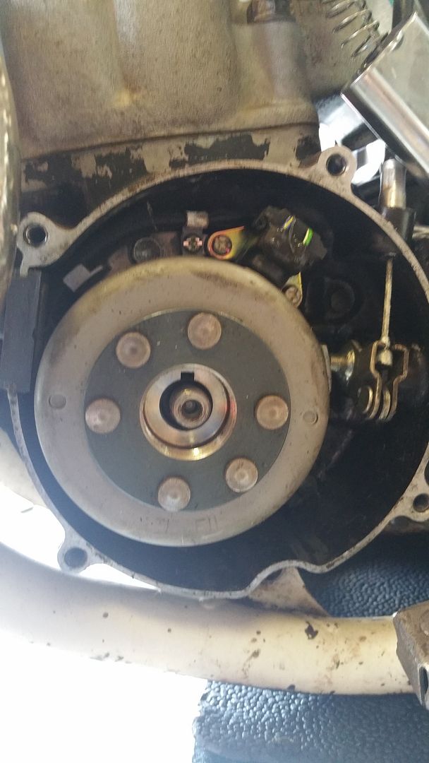

Got the stator and flywheel actually bolted down and bike would start but was an absolute bear to get going. Replaced the pipe with a FMF Fatty and it'll start right up with no issues.
Rode it a few times this summer with the plans of doing a full teardown over the winter to restore it. It was running awesome before I started the teardown. Looking at the piston through the intake it looked slightly scored, but not too bad overall.

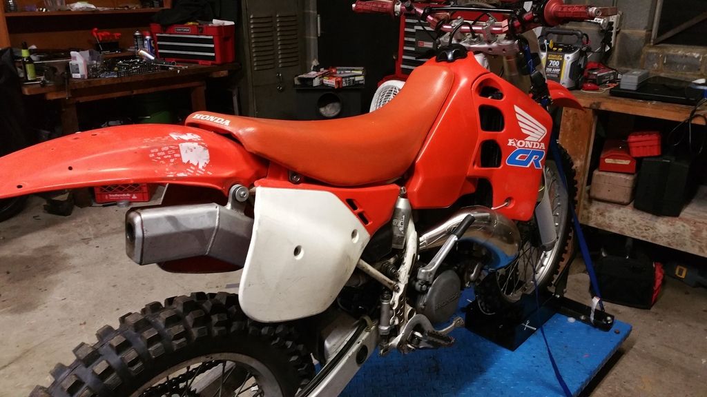

I picked up a newer seat, subframe, and airbox from ebay. Then managed to source the newer plastics from UFO in the 90' CR orange color. Win!
Pic Before the teardown

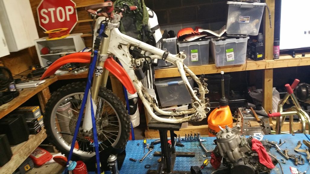

Making progress. Motor out

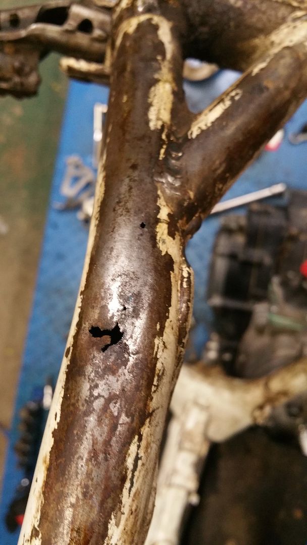

Got the electrical system and forks removed. Filpped over the frame and found this... Off to the fab shop to see if they can repair it. I'd source a new frame but this one has a street legal title. Plan is to powder coat the frame and subframe OEM White.
