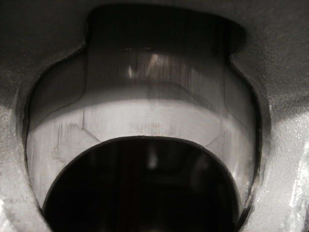

i took my reed off to look at the bore and saw this, felt it and it looked like a crack
soi tore it down
the motor has 9 pints of oil(5of 927 and 4 of super m) thru it at 40:1 jetted decent, so thats 80 gallons (320L) of gas thru it, heres what it looks like, i like the high precision casting on the dome :roll:
looks familiar, look at the stuff roosty sent bob, and the untouched OEM part of the cyl
looks like a bit of stop sign action, wonder if torquing the head studs has anthing to do with it, its never been bored, or touched
its not cracked, it just looks and feels like it, its marks from where the piston stops at the port
poped the head while i was on 927 and foud lots of carbon on the piston .5mm i guess(i had jetting issues then so it might not be the oil) and i chipped a bit off then switched to super m, and the castor gunk is still there, and you can see the clean bit where the super m didnt gunk up
but the castor left the head spotless, like it was just washed in solvent, and the super m left a bit of color
little black spot
got a mint PC works for sale 5 months old only $200 :lol:
crank big end side 28 thou, piston cly I could get a 4 thou feeler in without forcing it, front/back/bottom with the piston 1 inch from the top
just posting it up to see if theres something im missing, or is it just getting broke in?

man that topend looks like my first 500 teardown. Looks like you had a loose piston in there, maybe just a couple thousands extra. mine was at .007 and looked just like that.
nothing some proper machining cant take care of. Also throw that prox in the trash. I personally have had awesome luck with Wiseco. Im too nervouse about those brittle cast pistons, and always run forged. my 2 cents...

I started, about 20 years ago, putting quite a pronounced radius on the rear inlet port at the vertical/ horizontal join point, and radiusing the edge of the piston skirt at that point, plus getting rid of any stress raisers on the inside of the inlet (indeed all of the piston) skirt.
It effectively stopped that sort of cracking, even with me using up all the std pistons I've had in storage for years, with them going in with large clearances on both the piston / bore and big ring gaps. Just up to 500hrs, and I've run out the std pistons, so a re-bore , with a Vertex piston, that up till now I've seen nothing but good reports on, is on the cards - I think I'll have to go to at least a .5mm overbore, or more. I've been running the CRE very much on the cheap for the last 4 years :oops: .

To me, it looks like it has ingested a shit load of dirt, just by the markings on both piston sides. And the lower edges - either the piston had very bad finishing along the lower, outer edges, or the visual inconsstances along the arc / edge is alloy pulled/skuffed down. :shock:
I'm a bit of a cheapskate at times, and can appreciate that you might not want to spend money just before you spend big money for engine work, but even I would be wary of just slapping it back together. At least have the cylinder honed / cleaned, check clearances as best you can on the bottom end, and check the prep on the ports. From the picture, that could be misleading, it looks like the rear inlet has had no radiusing / clean up, and some of the others as well. It looks like they are that sharp, lint ,from perhaps, a rag you've wiped it with has been caught on the edge of the port.
That , and the state of the head, really shows that SH are just slapping these things together, with no real attention to detail or care. Perhaps it's a rare 'Friday arvo ' bike - I sort of hope so. But when people are paying so much for an SH bike, and the way SH tout them, you'd rightfully expect premium and expert prep and assembly. I think the last time I checked their 500 crate motors, they were priced at $6500 (I very much accept I could have that wrong). It's a lot of money, but, if it were put together with the care and perfect prep and set up I'd expect for that price, I could, to a certain extent, understand it. But not after seeing your pics and others.
