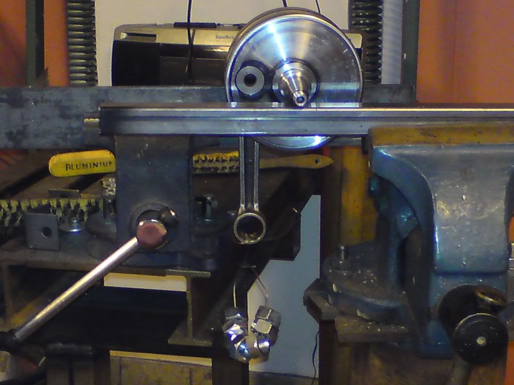

I made a crank holder to be able to hold the crank while spinning it to feel the unbalance first hand.
Just a short video of it:

This is how I measured the balance factor from the factory:

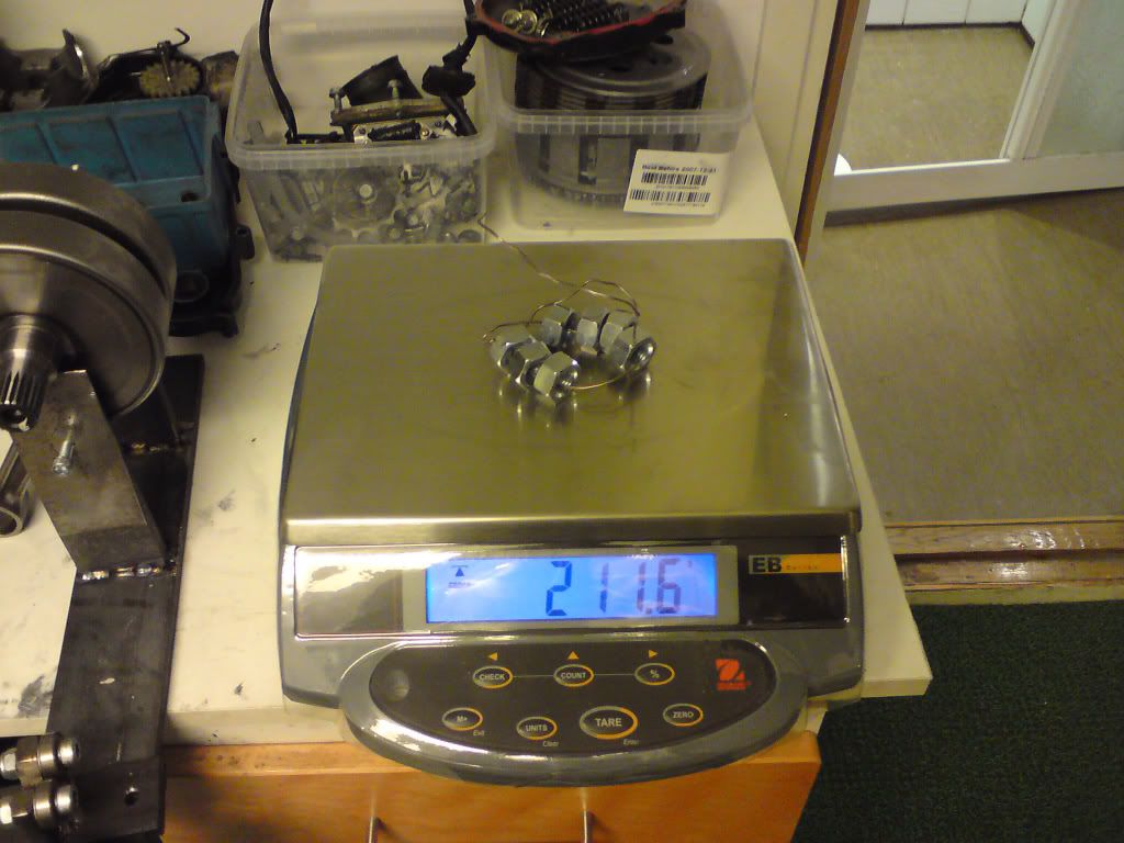

...and weighted the nuts:
