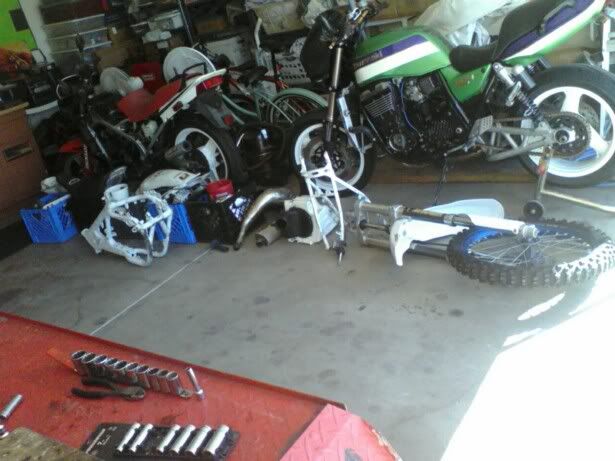

bought it for 350$
got it bonded
will have street title in a week or so

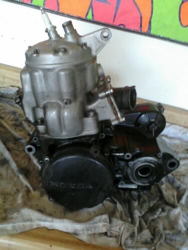

started w/ pulling engine
needs crank rebuilt and top end done (rod kit/piston kit on the way then off to ERIC GORR)

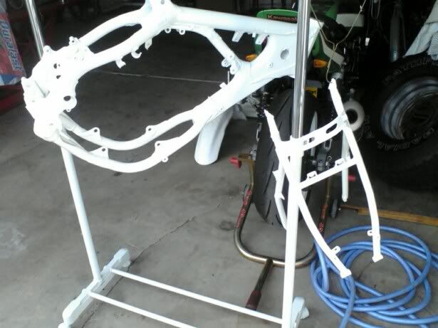

cleaned/painted frame
will do a full graphics kit so not to worried about plastics
will be red/white/blue when done. tried that anodized paint yesterday and it comes out SWEET if ya spray if over alum. paint/silver paint/chrome aluminum...
1st day i had it

all cleaned up and ready for crank

Looking Good! What color is that on your triple tree? Candy red??

Rue wrote:Looking Good! What color is that on your triple tree? Candy red??
actually its ANODIZED RED over a silver base (you can get it at walmart/car stores.. works really well ... cant wait to see my rims in blue again....
