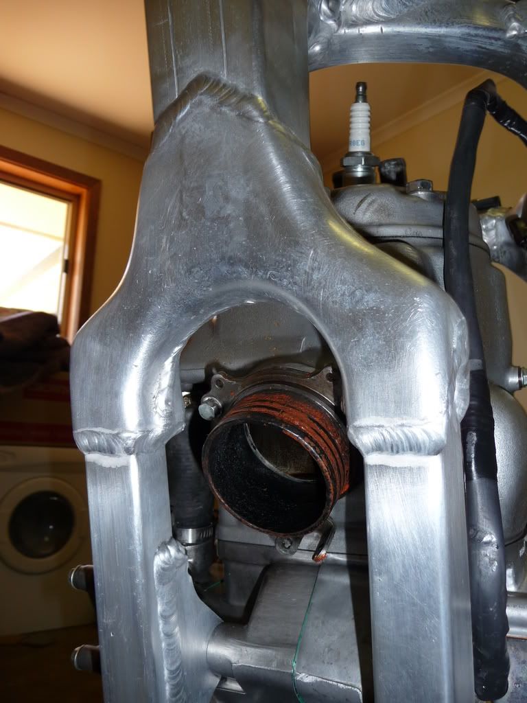

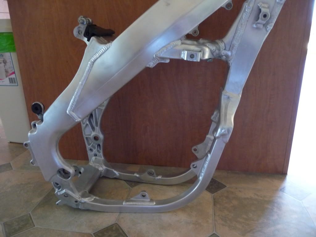

Gday, because everyone here seems to love the build pics, i thought id share some pics of a gen 3 250 frame i have been working on. i was aiming for the factory stock apperance.........

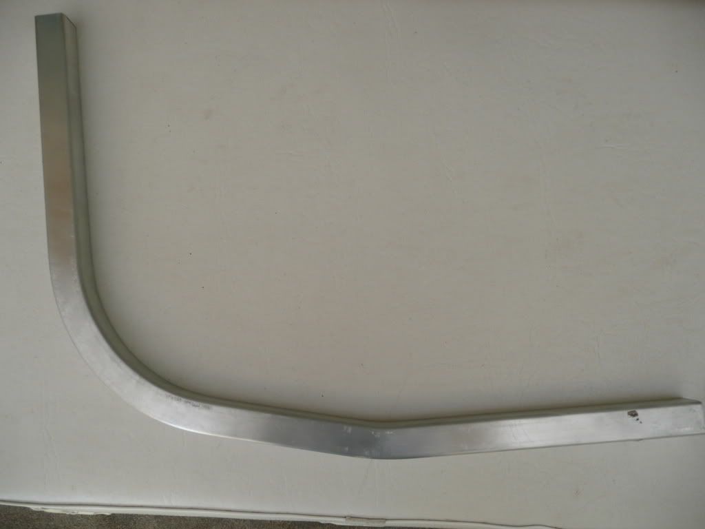

a mate of mine was able to get his hands on some 6061 tube and even bent the main radius for me(thanks juddy) all i had to do was put in the second small bend back near the pegs.

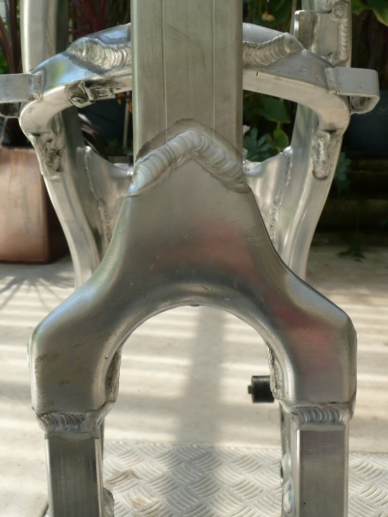

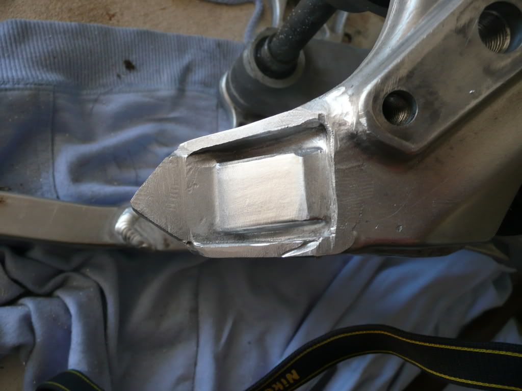

cradle tubes removed and the pockets cleaned up

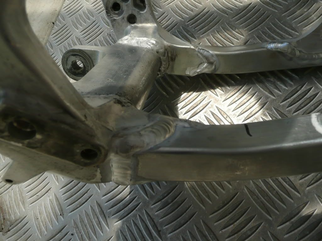

new tubes installed

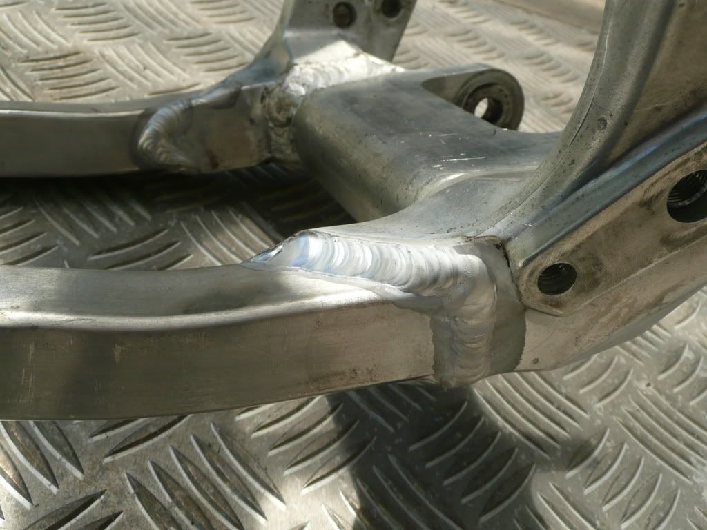

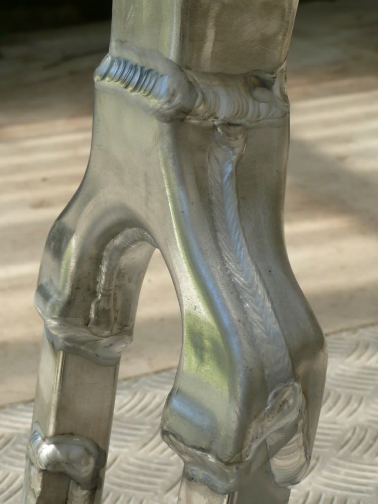

the stock y , now a little higher
a shitty photo of the result..

plenty of pipe clearance. just gotta weld the lower rad mounts on and the pipe mount to the right hand cradle tube and shes done.
very nice, does the Y beeing that high up bother the rads?
That looks awesome! Did you use the stock engine mounts? Good job!

I think doing a complete cradle is the 'right' way to do it.
Looks great!

Thanks for the comments guys . yes the stock radiators clash with the y in that position, but im using a set from my first build that have had the lower tanks modifyed for clearance. :cool:
