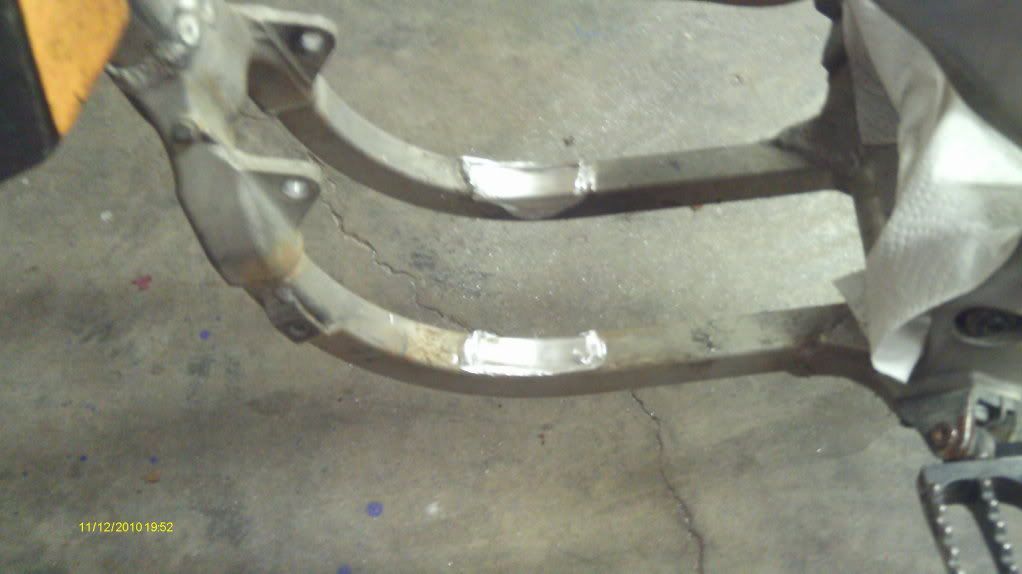

04 CRF250R conversion. Removed the 500 engine last night. Cut off the engine mounts and cut the Y out and sat the engine in the frame. I don't think the motor can be rotated forward much, the clutch housing is sitting on the frame and the front of the water pump is only about a .25 of an ich away from the frame tube.

Why did you cut the "doublers" off the frame??
:nono:
why indeed. why not a cr250 :D

I'm confused? I removed the lower mounts becuased they had to be moved. Was I suppose to leave the side pieces? The new mounts will go over the side of the tubing like the old ones.

Bob I checked your build out again and seen what your talking about. Ok made my mistake moving on. Swing arm spacers?????????????

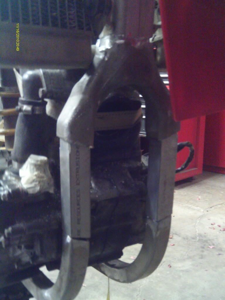

More pics

Dude, call Roosty or soliD brO and get the correct tubing.....
..... please.
AlisoBob wrote:Image
..... please.

Sorry I should have said. I have the right tubing just using that square stuff to mock it up and get it right before I use the good stuff. I actually want to get the cuts a lot better before I use the right tubing.
I have to get the inserts made also. Other than the tubing does it look like its right. The motor is sitting almost level and there is room for the crosshose between the radiators.

Got the cradle put togather with the right tube and the engine mounts are almost done should be welding today or tomorrow at the latest. Sorry for the pic my camera took a shit used a cheap one the wife carries with her.
