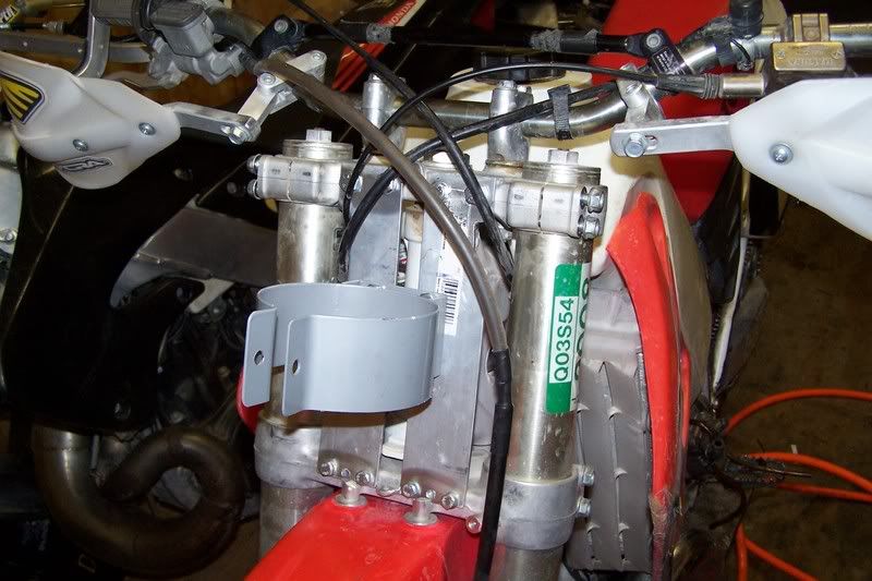

Throttle is done and I also boxed up a couple extra switches.
I threw in my old nitrous bottle mount.

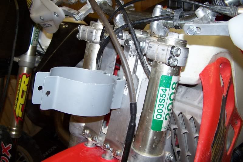

The
L shaped sheetmetal bracket bolts to the front of the triples and the cradle bolts to the L bracket.
The v bracket bolts to the l bracket and to the upper triple if I remember correctly. You'll have to drill and tap a hole in your upper triple- I used an 8-32.
The front number plate then attatches to the v bracket.
The switches can be adjusted for depth with the lock nut or by taking the black button off the switch plunger end. You can also remove the jambnut and use a rubber o-ring..... that's what I use.
Word!

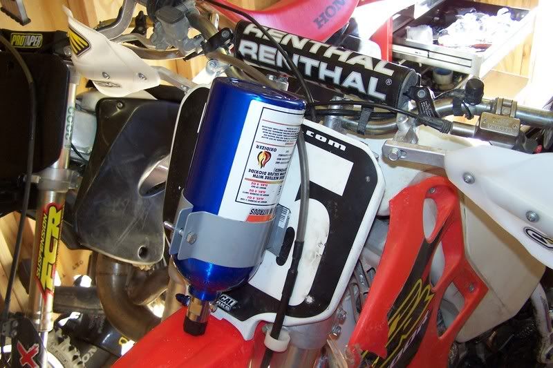

I started on my bottle mount abou 30 mins ago, its different :lol:
I'll get some pics when Im done.
Thanks for the switch man :cool: :cool: :cool: :cool:
Nah man im actually quite proud so far!!!!!!
I can put stuff together no problem, I have an issue with fabbing that goes further than duck tape and zip ties tho.......

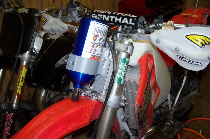

Rite bottles on, I thought I could run it with the numberplate but the top bolt mount is interferearing with the bottle so I've got some more chopping to do.....
It feels solid as hell, I picked up the front of the bike with the bottle and it isnt moving at all.

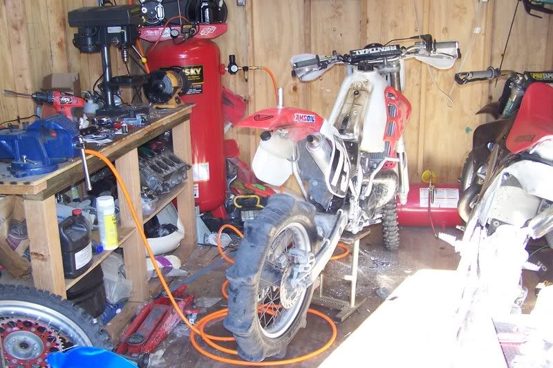

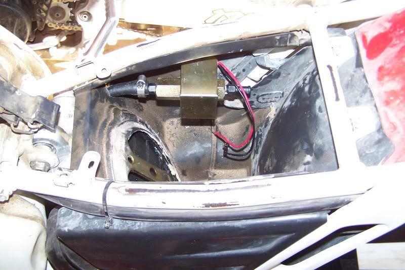

Bobs worried im turning my bike into a bomb so heres an update as to what Ive been doin today....
Got the bottle/numberplate issue solved
Installed fuel pump
Ran gas line
My shed is looking wrecked so im taking a beer brake to tidy up...
Dude, you didnt even wash your bike before you tore it apart?
http://www.urbandictionary.com/define.p ... ngineering
And stop running your fuel pump, with no gas..... " To see if its working"..
...it soon wont be.
