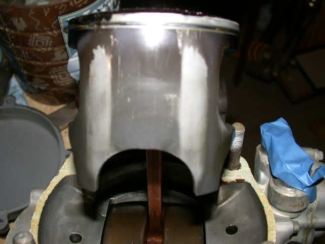

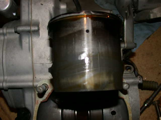

I had swaintech strip the vertex moly coating and put PC9 on. The thick coat is the same stuff, PC9 just thicker. The coating process for the thicker application is not able to keep the thickness precise, it varies around .002 so it's really not a great fix for loose stuff but the race clearance method will remove high spots
These pics are from a new motor with a vertex set up at .003 measuring off the coating not the piston. It was running on 927 and had a coolant leak. It was running evan NPG-R and was hot enough so it was pinging and steaming the NPG-R out of the overflow. It Didn't seize or loose compression. The single ring got quite a bit of wear and the new nikasil bore got scored up. At the time I noticed the steam a riding buddy was on the bike and I noticed the steam and called it a day.
