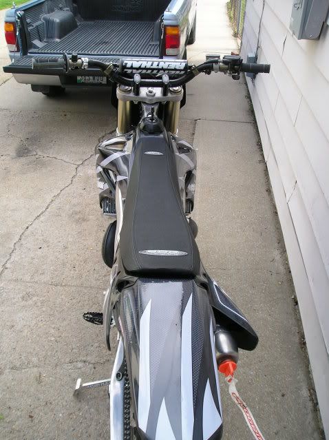

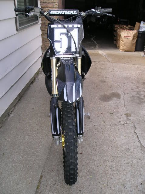

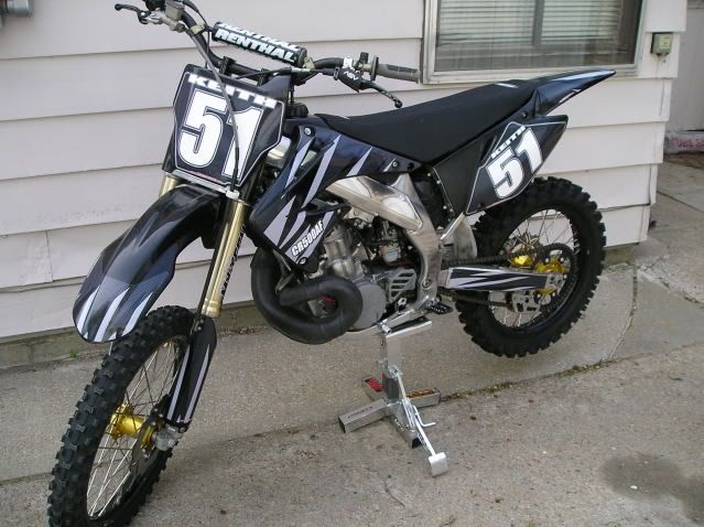

Figured I had better throw in some completed pics to close the thread. Added MX-Tech suspension, Renthal twin wall high bend bars with ASV F3 levers and got some black fork guards.
Here is the beast all cleaned up and ready for the long Iowa winter, what you can't see in the pics is the shrouds are all scratched from my knee braces and the nice polished frame is getting dull from the boots!! Actually looking like a dirt bike now :lol:
Graphics will come this spring when I get them for the 88 TRX250R I am building.
Grand total of this bare frame up build with the engine, all the bling, labor, small fortune at HPD and the suspension is just under $5k...

How tall are you? Those bars would work for Bob or Jay fo so. Also that front brake line might need to be a bit longer with the ape hangers. That's one nice looking bike though!

Oh yeah I am 6'3-1/2" tall, 35-36" inseam, but long upper body; shirts always fit short on me so I am always flashing the Glock :wink: The bars are RC high bend with MSR 1 1/8" adapters on stock lower clamps.

I finally got my beast to the point where I would finally call it complete...
Everyone that sees it calls it an AF, so it's now an AF, hopefully AJ and Metallica don't show up at my door :wink: Oh well, it's one of a kind, made by me for me!!!

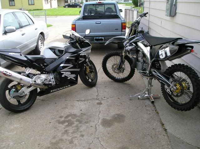

Here is a shot of the missile next to the rocket :cool:
