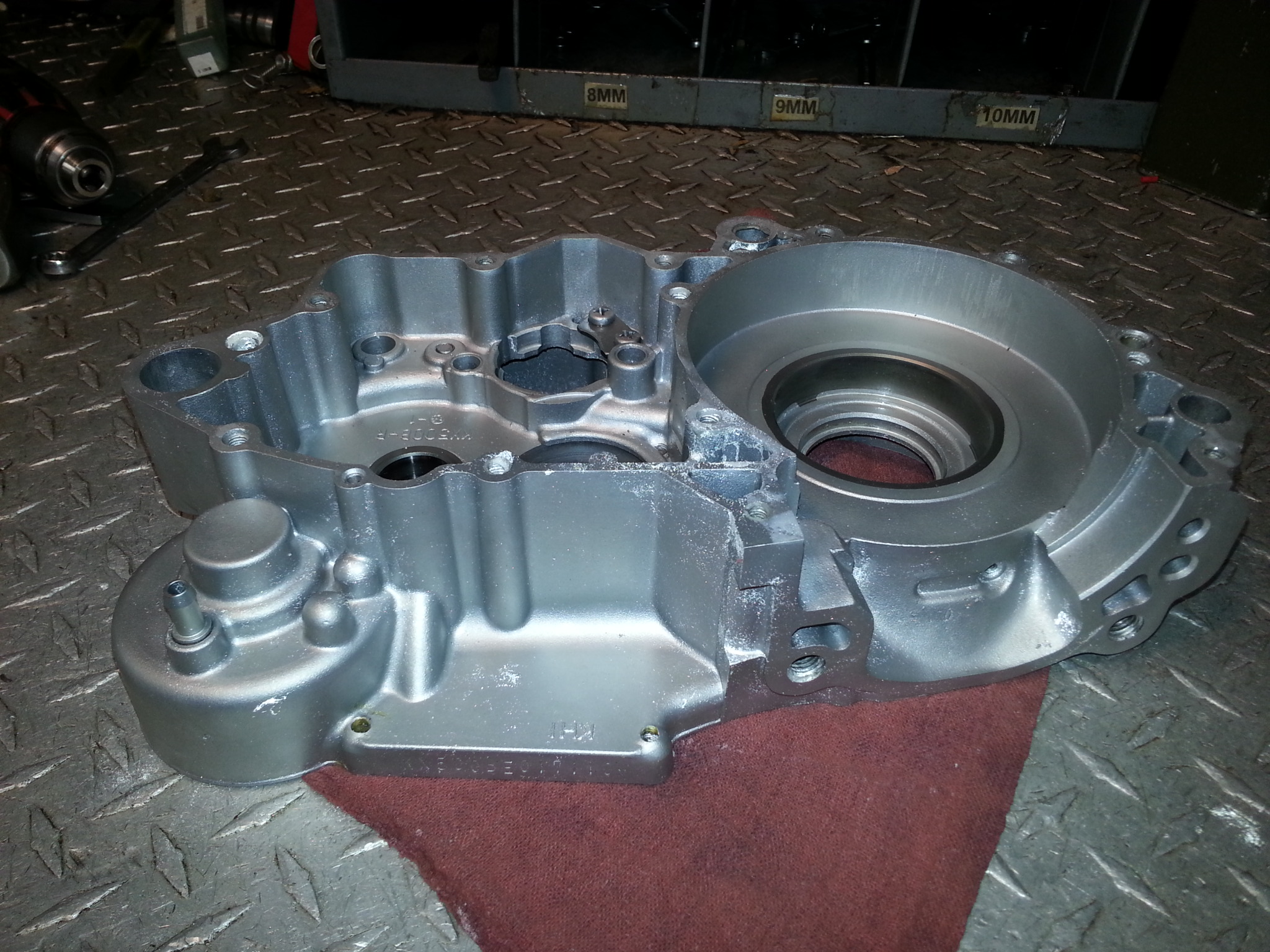

I didn't get it rinsed real well but it sure does a good job.
