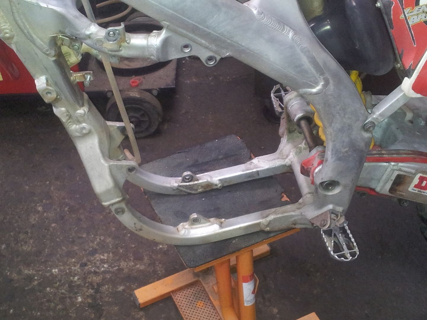

well today I finally got some time away from work, university and doing dads work to get started on the build.
started out the day with the bike sitting like this.
then got to cutting out the cradles.
the left hand side cradle removed. Taking this to get a new cradle formed, so il be sure to get the correct bend matched up and correct density etc.

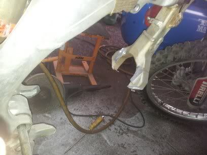

Then got the excess tubing that was left in at the peg slot out.

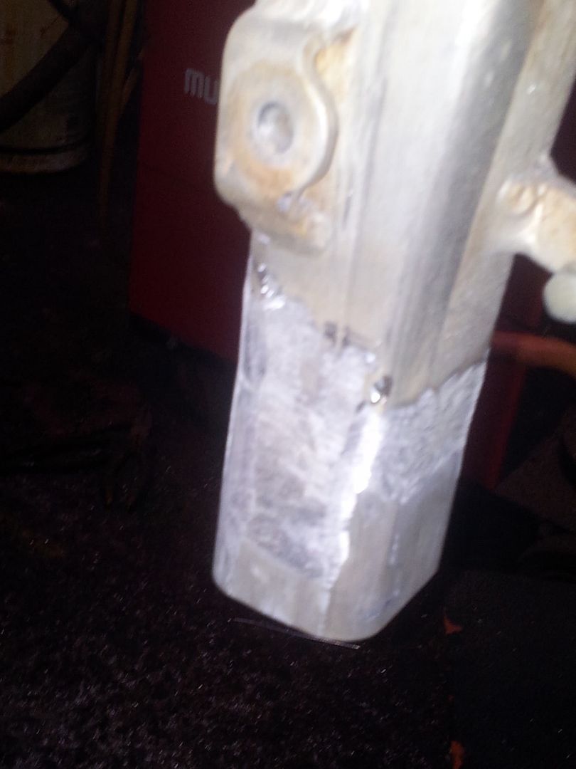

cut out the y piece then.
done some grinding after removing the y piece just to clean it up a bit and remove rough edges.

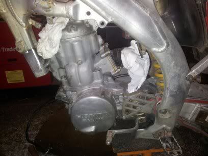

next set the engine in and checked where i would need to cut for exhaust clearence. i know engine isnt 100% level here, but got the spirit level out and fixed this after.
thought id check for tank clearances etc.

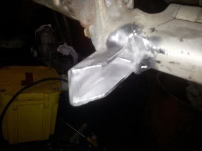

By end of the day got the frame adjusted for the y piece ready to be tacked in, and new cradles to be set in etc.
